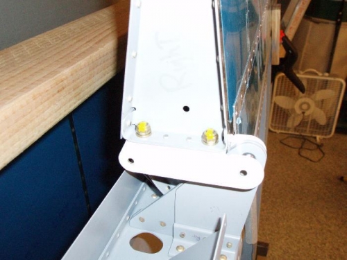

Finally, I drilled the hinge holes with a number 12 drill for AN3 bolts which is about 0.186 inches per my calipers. Then I installed the hinge brackets and torgued the bolts to 25 inch pounds. I put inspector paint on the bolts to remind me they have been torqued and to show if they ever come apart.

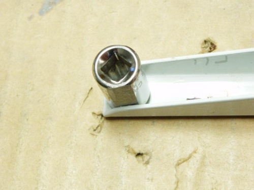

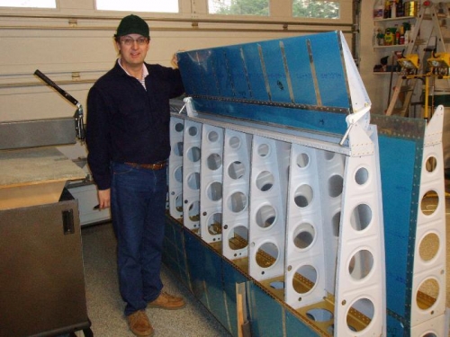

I had to file down the sides of a socket in order to get it on the head of the bolts in the skinny hinge bracket. Then I put it on the wing and moved it. This is the fun part. The gap between the top skin and the aft end of the main wing skin is about 1/4 inch and constant its full width. So I think this installation will be just fine. I'll do the final installation after assemblying the flap, per the plans.
Now I've gotta go assemble the other aileron.
Hinge Brackets installed and torqued
New Tool a filed down socket.
Aileron works.
Aileron works.
