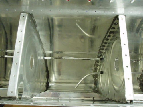

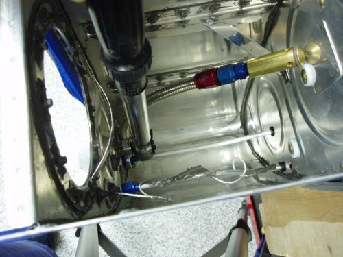

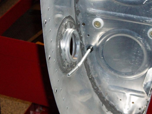

I attached the fuel vent and return lines to their elbows. I torque them to 55 in-lbs. I also used a little thread sealant, which will give a little resistance from turning. I bent up the vent line to be at the high point near the cap, and I bent down the return line to return near the bottom.
Torqued the fuel vent and return lines on
Bent up the vent line
Bent down the return line
