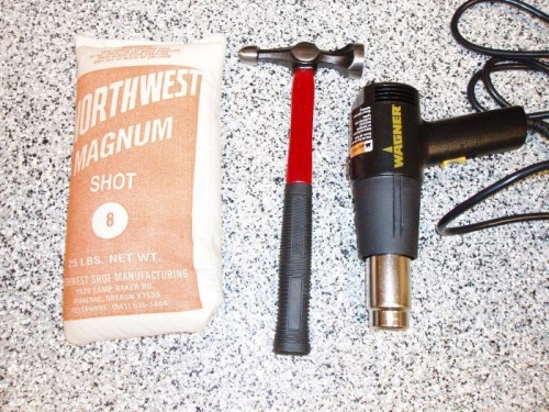

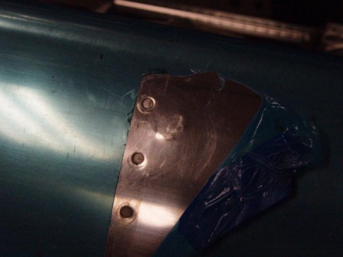

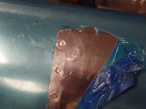

When I removed the first tank from the cradle after riveting the internal 5 ribs I discovered a dent. Or more accurately an "outie". I remember now, I did drop my bucking bar, but didn't think anything about it, at the time. Well, it made a dent from the inside. I read Van's Airforce and there are several opinions about turning an "outie" into an "inny" or just a dent, and then filling it later at paint time. Some "experts" say, hit it with a hammer, or with your rivet gun. Some say, but a molly or bucking bar behind it, but the "expert" that I believe said, "put a bag a lead shot behind it, warm it up with your heat gun, and tap it gently, repeatedly with a body hammer and the metal will flatten back out or at least become a slight inny. The use of the lead is to give it some rebound movement so you don't crack the aluminum. Continued on next page.

Here is the "Outie" ouch.
Ugly in just the right light
Tools to fix it.
Tools to fix it.
