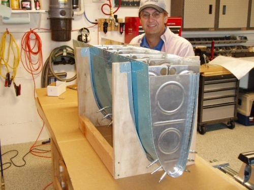

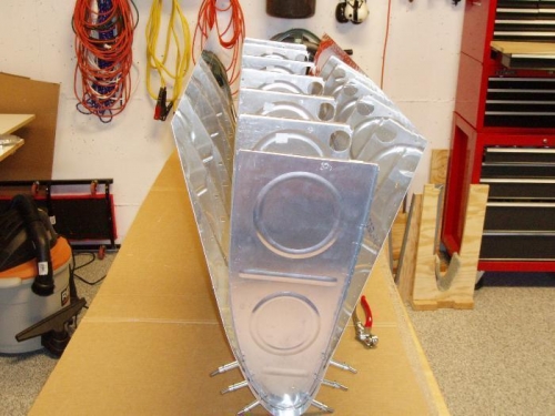

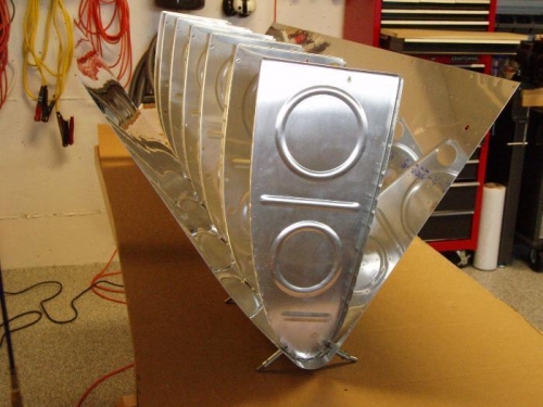

I started the fuel tanks today. First I assembled the right tank skin and ribs. I started out with the skin in the fixture but it was hard to push the ribs all the way into the tip of the skin and I discovered I could easily cleco the skins to the nose holes in the ribs if I let the sking lay open. So I clecoed the first few holes starting at the nose and then put it in the fixture to finish.
Easy to put in first clecos if left open like this
First few clecos go in
Finish with tank in fixture
