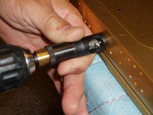

3) debur inside only because outside will be countersunk
4) counter sink rivet holes with #40 for flush revits
5) counter sink screw holes with #30 to a diameter of 0.365 - 0.375. I targetted 0.365.

countersink rivet holes.
