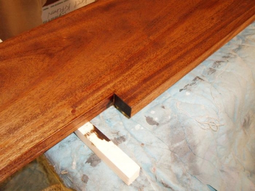

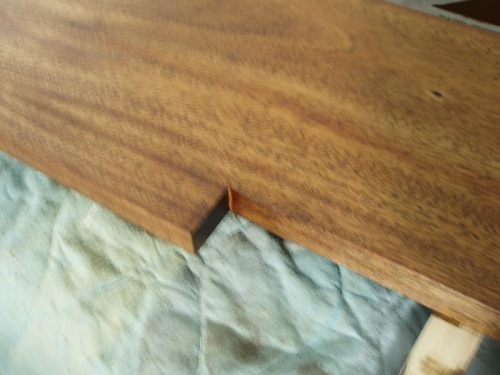

Brief Description:  Furniture Bathroom Cabinet 11 Top Corner Cut
Look at this detail? How did I cut that notch out of the top and still end up with a smooth front edge. Can a band saw cut this? Nope, it leaves teeth marks. Did I cut it on table saw with small notch underneath? Nope, notch would show in the tight angle. Sabre saw? Nope?
I ripped the whole front edge off, cut to length just the center piece and glued it back on. Pretty good yeh? You can't even see the glue line. I used a jointer on the edges which makes for a really smooth interface upon glueing. And I lined up the removed piece so the grains match, almost.
Now that you know, I'm sure you can see the glue line in the grain. Oh well Jody can't see it.
For some reason the flash is making this wood look red, but it is really brown.
