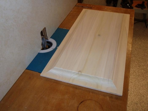

I use a large vertical bit to router down the outside edge of the door center panels. Notice the large and high heavy duty fence on the router. I made that years ago.
I route the perimeter until the outer edge fits flush inside the door frames.

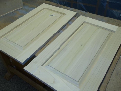

Finally I glue the center panels into the door frames and I have two doors.
Routng the door panels
Big bit routes perimeter of door
Completed doors
Completed doors
