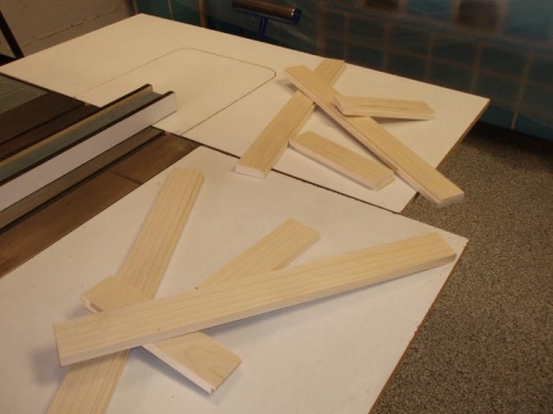

Time to make the doors. I dread making these because I have to use the router and it makes a lot of dust and chips. I'll make raised panel framed doors. First I make the frames. These are 1/2 inch larger than the opening. And I'll be routing 3/8 groove around the perimeter so they fit part way into the cabinet.
Door frame pieces
Door frame pieces

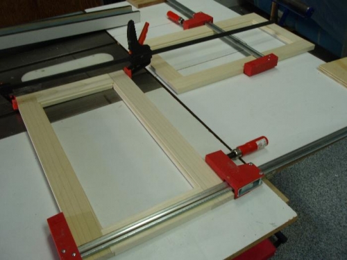

Glueing the door frames together

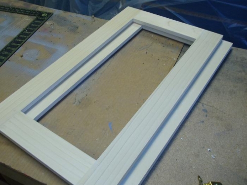

Here are two frames
Here are two frames
