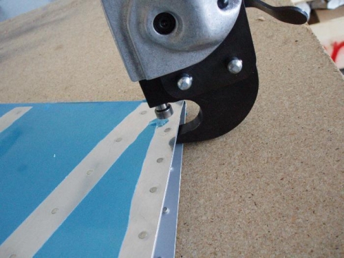

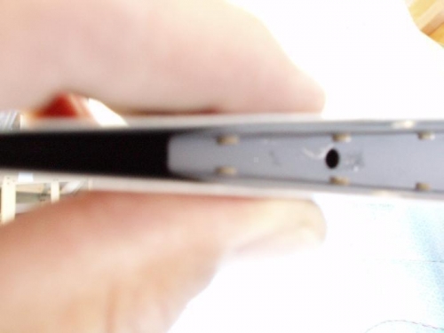

Tail - Final rivet of tight rivets
One final thing I did today was use my new 1" yoke to squeeze the rivets in the very trailing edge of the rudder. I got them all. No pop rivets.
No pop rivets
Modified yoke for tight spots
