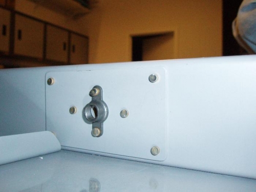

After removing 60 rivets to open up the skin, I then drilled out the universal rivets in the platenuts and doubler. I re-revited them inside the elevator on the aft side of the spar where they are suppose to be. Everything worked great. I blew out all the chips and shavings and checked my RTV which had dried to a rubbery feel and seemed to be doing the job of holding stiffeners together.
Skin is open
Skin is open
Platenuts are back where they should be.

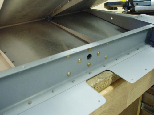

Inside shot of relocated platenut
