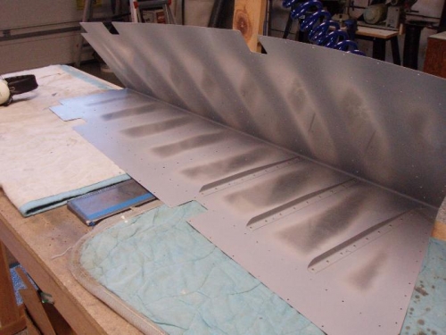

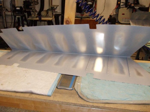

Brief Description:  Elevator - Back Riveting Skins and Stiffeners

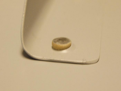

I back riveted the stiffeners to the skins. It goes pretty quick. I did notice that the side of the shop head looked different than normal. At close look I decided it was due to the dimpled stiffeners because dimpling them stretched the metal a little. The factory head side looks great. And the shop head is tight, tough, and will fly.
Notice pads on each side level and protect skin

Gotta becareful to rivet only over plate
Notice side of hole
Notice side of hole
