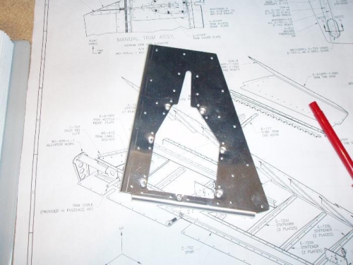

I studied the plan and drawings for a long time to figure out why we the plan wants me to address this cover plate now. I located the #6 holes and dimpled them with the #6 die. I clecoed it to the left elevator skin and matched drilled. I primed it. And attached the nut plates.
Dimpled #6 Holes
Dimpled #6 Holes

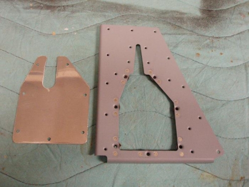

Primed
Primed

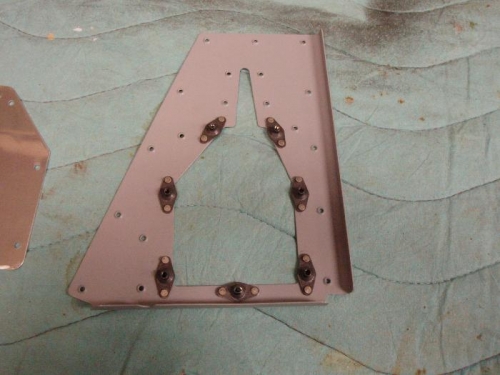

Squeezed on nut plates
