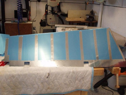

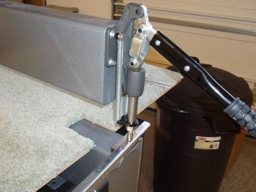

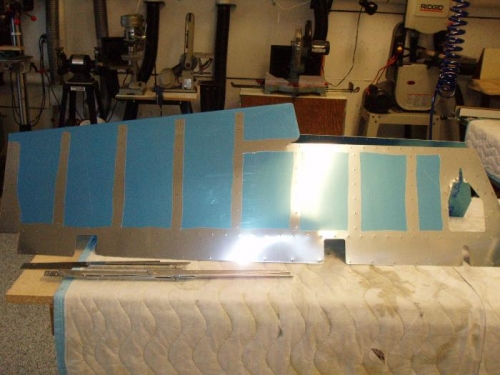

I tried my brother, Ed's, technique of removing the blue stuff with a soldering iron. Worked okay, but I get a little scratch on the aluminum. I'll dull my soldering iron tip a little. But I do like some skin protection that the blue stuff adds. I used a straight edge to get straight cuts in the blue stuff but that took a long time. So then I tried it free hand and you can't tell the difference in photos below. Free hand is much faster. I use the C-frame for almost all my dimpling instead of the squeezer. I have a small diameter female die that lets me do the ribs and stiffeners without bending the flange or interfering with the flange radius.
Straight Edge cutting of blue stuff
Free Hand to cut blue stuff
C-frame for dimpling everything
