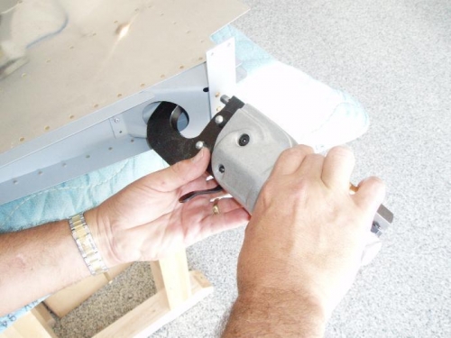

Brief Description:  Rudder - Difficult Revits to Reach

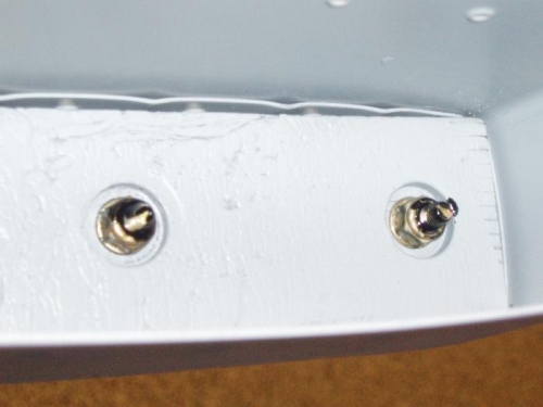

The frame required a few parts to be riveted after the skins were put on. I should have riveted the horn brace to the rib prior to putting on skins and then I wouldn't have to use pulled rivets. Notice the yoke does fit, just barely to squeeze all the rivets. Also I put paint on the weight nuts because others did. I guess this ensures against backing off the nut if things vibrate.
Off set Yoke does reach
Yep here to.
Yep here to.
Paint on the weight bolts.
