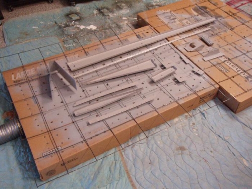

Brief Description:  Rudder - Priming the frame w/ Benson

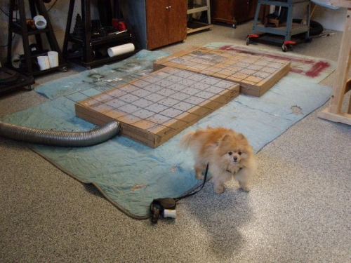

I primed the remaining rudder parts tonight. Below is a shot of my two-box setup. The holes suck air into the vacuum to help control fumes. I'm still using the degreaser/cleaner from Stewart Systems and SEM self etching primer.

Primer sticks and covers in 3 light coats

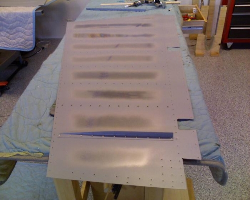

I sprayed the skins on the inside
