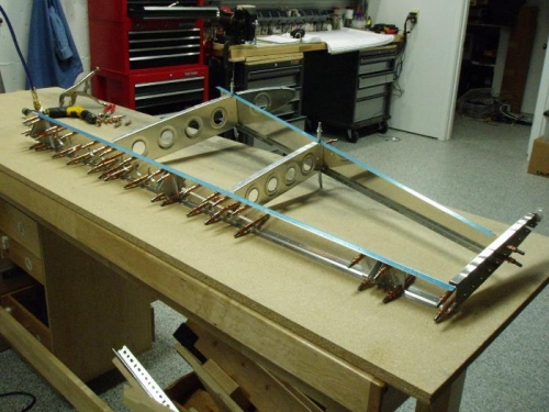

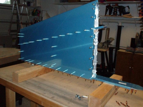

I started the vertical stabalizer (VS). Not many parts. I've cleoed it all together and am drilling and match drilling all the holes. Frame is #30, skin is #40.
Frame cleoed and drilled
Skin cleoced and drilled

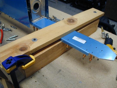

Here is how I'm holding the VS
