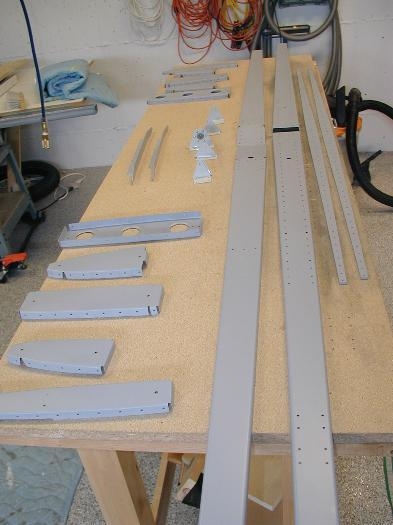

Brief Description:  HS Primed Parts

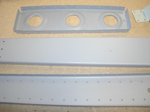

The primer went on pretty smooth. Using rattle cans does through out a small blob once in awhile, but those blobs smoothed out, for the most part. I used 3 thin coats so self etcher has time to do its thing and ensure a good stuck on primer. It did not cover the ink marks completely, but did cover them up a bit. Later I had to do some touch ups because I had very think coating on some of the side flanges. But next day the primer seemed hard and wouldn't scratch off. So on to riveting.
HS Primed Parts
HS Primed Parts
Hard, Stuck on coverage
