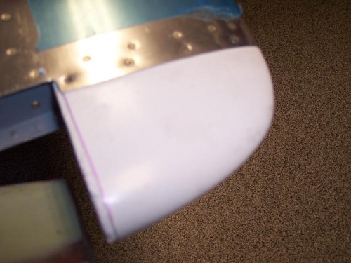

I rivetted on the plastic tips with the 1/8 pulled rivets.

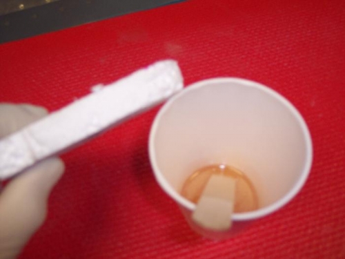

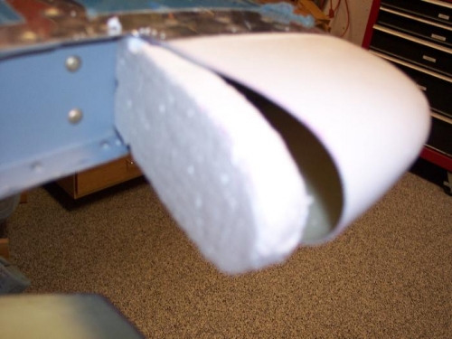

I'm closing up the end of the tip using foam. The foam is easy to shape and very light weight. I glued it in place with Marine expoxy.
Rivet on tip
Made foam plug
Glued in plug in place
