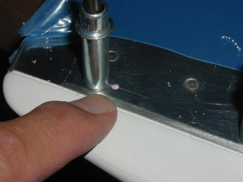

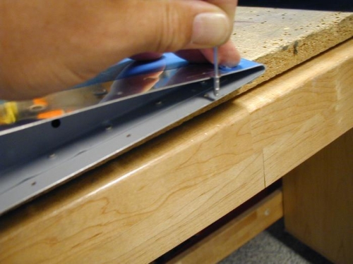

As I was drilling the holes I realized that the end hole on the most aft were across from each other and would be difficult to get a rivet into both holes. Because the first rivet put in would block the 2nd rivet. This was so only at the most aft end.

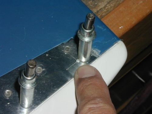

So I offset the bottom hole a little.
Sure this left a hole on the skin, but I plan to smooth this over with fiberglass anyway.
No room for opposite rivet
Offset bottom hole a little
Offset on both elevators
