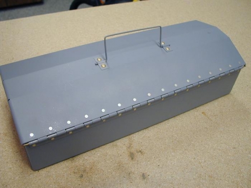

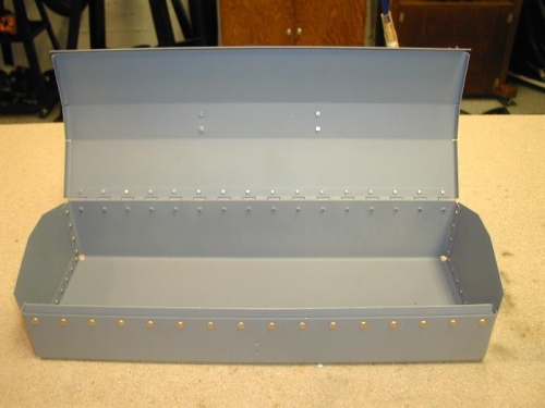

Brief Description:  Tool Box Complete

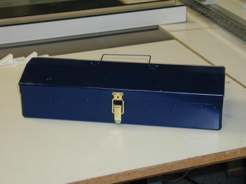

Tool Box is omplete. I learned the following: 1) Use back riveting whenever possible, 2) squeezer will detect if a longer than normal rivet has been used because it only squeezes with force the last 10% of its stroke and 3) I really gotta get painting fumes and over spray under control. I primed and painted my tool box, mostly because I wanted to work on a painting booth with good fume and overspray control. See my tools section. It went fine until my last coat of blue spray paint. The cold weather caused the paint to orange peel. I'll fix it later.
Back Rivet.  Nice.  I like it.
I like the rivet primer look
The Blue Tool Box
The Blue Tool Box
