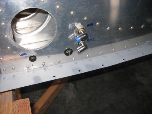

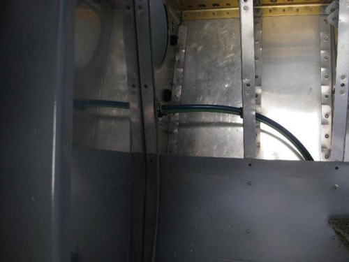

Brief Description:  Pitot static system
Couldn't work on the canopy so I worked on the Pitot/AOA system instead. To facilitate wing removal and to handle the various turns I decided to put in a 90 degree connection at the fuselage. As you can see the 90 degree is connected to passthru I purchased from Poweraire. The Pitot and AOA lines run under the pilot seat, make a left turn through the seat rib and connect to the Powerair connection at the fuselage skin. When I put the wings back on the lines coming from wing will connect at the fuselage skin. I wanted to minimize the number of inline connections, so this will give me two. The only other connections are at the Pitot tube and the ADAHRS.
