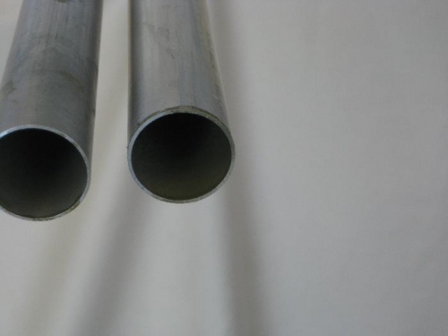

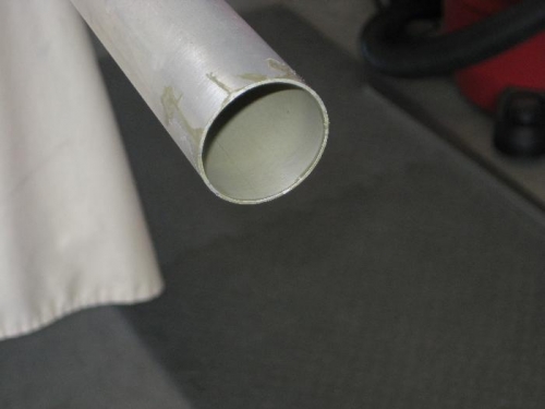

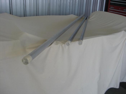

Just a short visit to the hangar to prime the inside of the three flight control push tubes. Pretty easy process after the tubes are prepped and one end is taped over. I mixed some acid based primer, about 3/4 cup (which was too much.) Then slowly pour in the open end of the tube and swirl around. I went through the process twice for each tube. They are now drying at the hangar, ready for the end bearings to be mounted.
End taped ready for primer
Aileron tubes
Aileron tubes
Elevator  tube
Elevator tube
