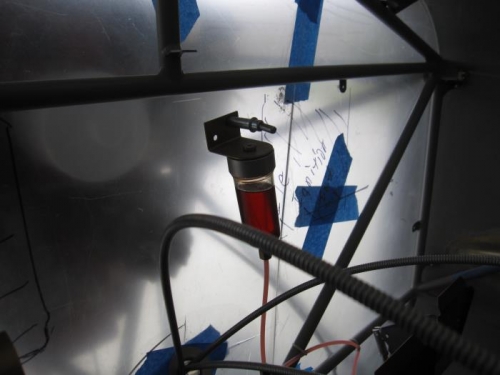

Brief Description:  Bleed Brakes 1

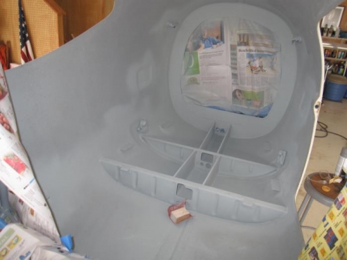

I bled the brakes for the second time. I had no problems on the left side, but the right was a different story. The line wound not bleed from the caliper up only down from the master. I posted a note and got the tip to check to ensure the brakes were not actuated and found the problem. I had one of the right brakes actuated slightly and it created a check valve situation. Thanks glastarnet! I also got the first coat of paint in the cargo area. I am going check this after it dries to see if I have a better gray to gray match. I also have to add the speckeling which should change the look of things. On the first run I just want to get a good bse coat.
