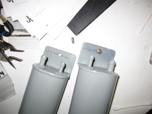

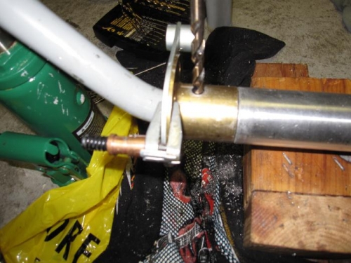

Brief Description:  Left Brake Flange
I drilled one of the two holes for the left brake flange. I have the process down now so slow you can see the twist in the bit and lots of cutting oil. Step up the bits slowly as well that hardened steel is tough. I dread drilling the tail dragger mains later. I also did some light drilling and drilled the top of my header tanks.
