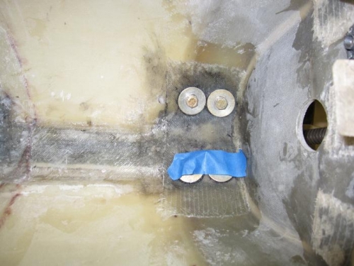

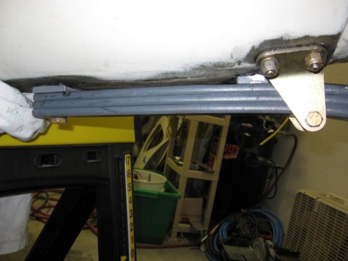

Brief Description:  Tail wheel #1
I mixed a batch of milled fiber and epxy and set the tail wheel wedges and internal hardware. The thick batch of milled fiber is to do the liquid shims for the wdeges and internal washers. I need some new hardware as a few of the bolts in the call out were a little short.
