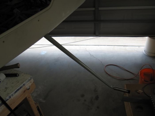

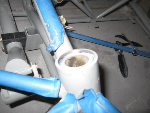

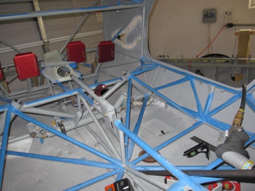

Brief Description:  Landing Gear #1
I started the hone and fit operation for the landing gear. I am going to drill the gear for nose and tail gear. I got one side good and a good jump on the other side. I figured out the the air drill with my brake hone worked best. One other tip is to keep some light oil in there to keep the honing stones clean and doing their job.
