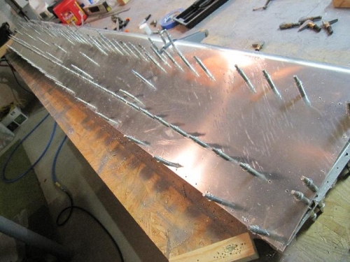

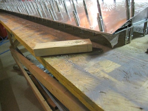

Brief Description:  Right Flap Trailing Edge
I aligned and fit the trailing edge wedge between the skins. I generally aligned it from end to end but is would snake fore and aft between the skins. So I clamped the ends in and worked out from the center and drilled index holes to fite each section between main ribs. It worked pretty well. Like so many things you do it better the second time around.
