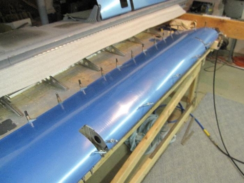

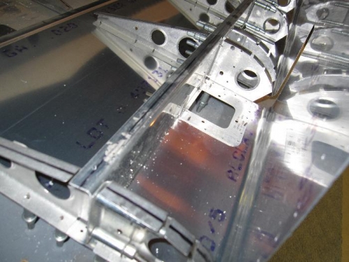

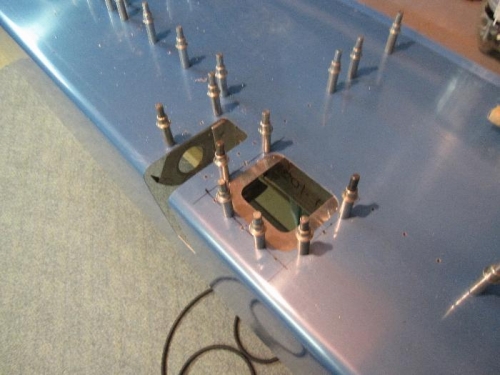

Brief Description:  Left Aileron
I completed drilling the lower right skin. I then laid out the rivet pattern and fit the inspection hole covers. I then drilled the rivet pattern and fit the inspection hole covers and drill #19 holes for screws there. I also drilled the portion of the doublers that rivet into the spar. I rolled the aileron over and fit the top skin. Miek Cencula was over with his dog Snickers and he and Ace were dog-tainment while Mike and I fit skins. We got it fit and a few index holes drilled and training edge clamped in place from here it is a one man job.
