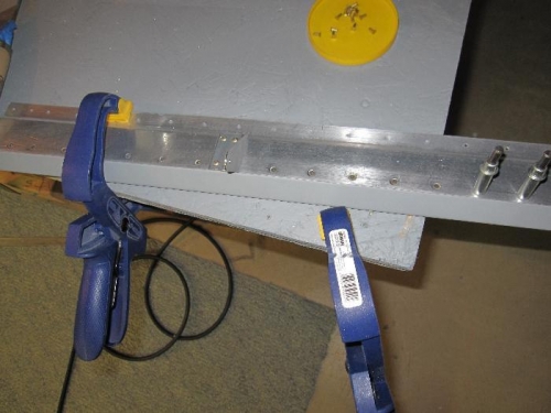

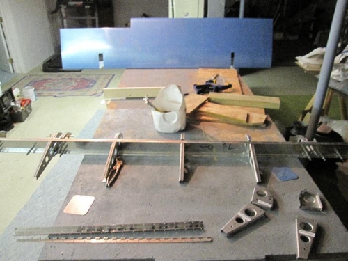

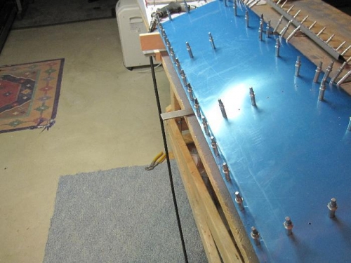

Brief Description:  Left Aileron #1
I riveted the trim tab together except for the trailing edge. I also drilled the trailing edge of the aileron and pulled all the clecos. Next on to cleaning and prep work for riveting. I am going to get some 3/8 by .032 strips to install in the training edge as they do in the TWTT program as well as epoxy the edge before riveting.
