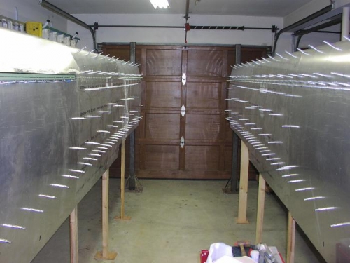

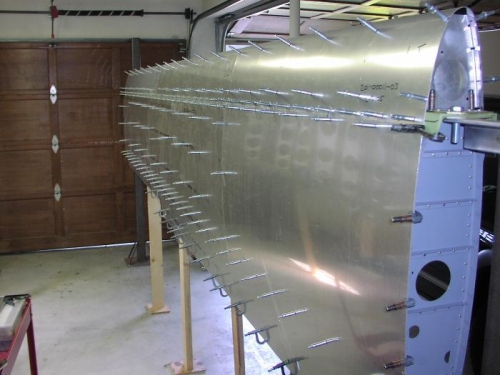

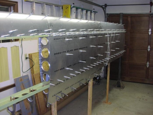

Brief Description:  Fit upper Main skins Left and Right
Good building and a big thank you to fellow building buddy Brent Owens for puling my fat out of the fire with extra silver clecos. Fitting these skins were not as tough as the nose skins, but care must be taken to make sure you have the right skin and double check you don't put one in inside out. The outboard and center skins are directional, but watch the inboard skin. it is symmetrical and fits at the main ribs at he edges, but if you put it on inside out the cove ribs will be off. (ask me how I know) They turned out great.
