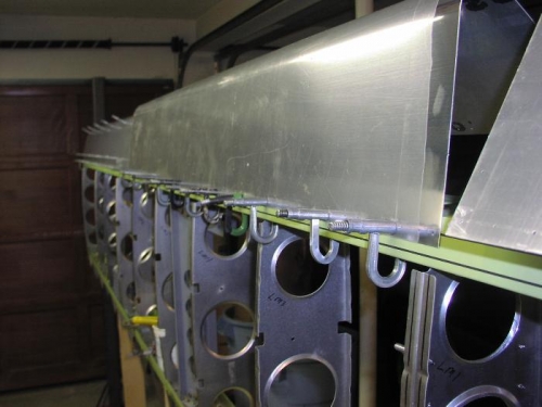

Brief Description:  Center nose skin left
Lined up the center left nose skin section. Peeled the plastic out of the way for the overlapping skins. I also transferend the center lines for the nose rib to the the nose skin. I also got a hot glue gun and glued in gussets to keep the nose ribs square with the spar.
