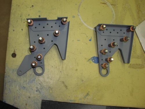

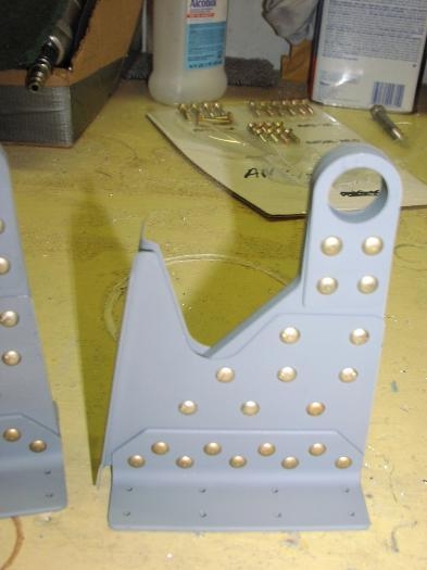

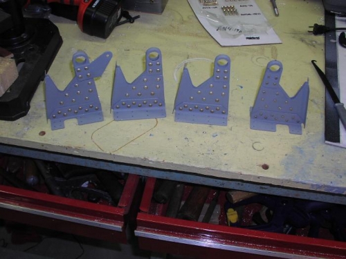

Brief Description:  Rivet and finish hinge assemblies
I finished the priming the other two assemblies and assembled for riveting. I also scared up the rivets necessary and started getting these riveted up. Here is one helpful tip I used a pneumatic squeezer and I got it set up for the web and did all four. Then got rivet size for the bearing double and did three of four ( I had to read just for the assembly with the anti servo tab on it) then get rivet size for the bracket rivets and adjust the squeezer and do all four.
