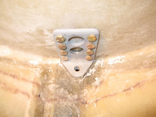

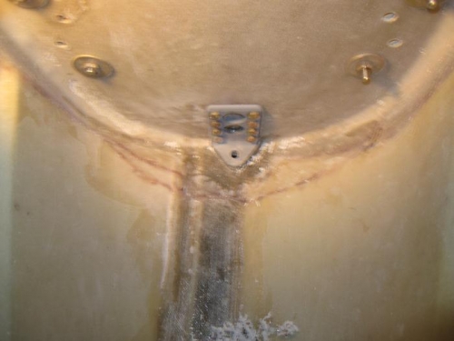

Brief Description:  Tail wheel forward spring attach
I mixed a mill fiber and resin mixture to bed the bracket in. I tightened the bolts and put a light on it to get it to cure quickly. I then drilled the hole through the bottom of the fuselage for the bolt and drilled drain holes on each side of the bracket.
