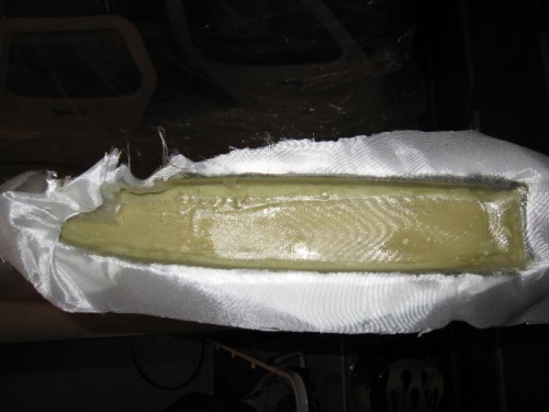

Brief Description:  Clean up the Vertical fin rib.
I peeled the peel ply and trimmed up the glass. I found a couple of voids in the glass and the shell. I mixed a batch of resin and used a syringe to inject resin to fill the void. It is not weight friendly, but will fix the bad bubbles. It is not a technique to use a lot, but I am getting good results getting the last 5% to get to a perfect layup.
