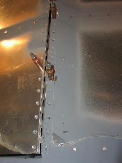

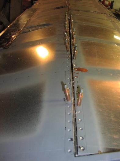

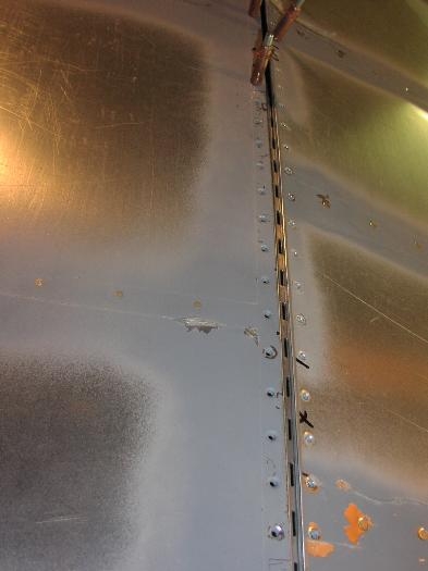

Brief Description:  Drill Index hole on the Stabilizer Hinge
Did lots of alignment and used mini bar clamps to hold hinges in place trippled checked placement and drilled the index hole on the horizontal stabilizer side. Taking this slow as it can be a tricky operation, but so far so good. It looks like a good 3/16 down the length. I have checked the travel of the elevator and range of motion is looking good at this point.
