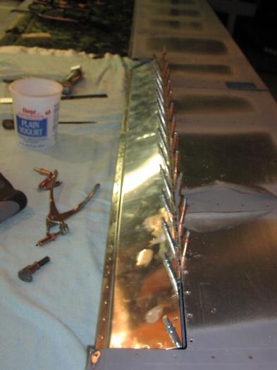

Brief Description:  Mounted the trim tab hinge
Aligned and drill the trim tab hinge per plans and it looked great until I took it apart. The rivets on the elevator side violate edge distance. I am going to order a wider bit hinge and redrill. I'll move on to fuselage and garage prep in the mean time.
