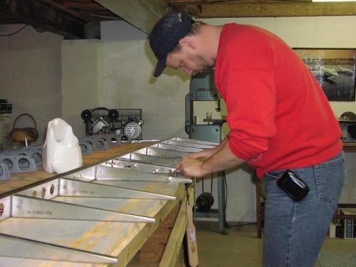

Cleco ribs to forward spar
Put the spars together with silver clecos and then drill out to #30.
