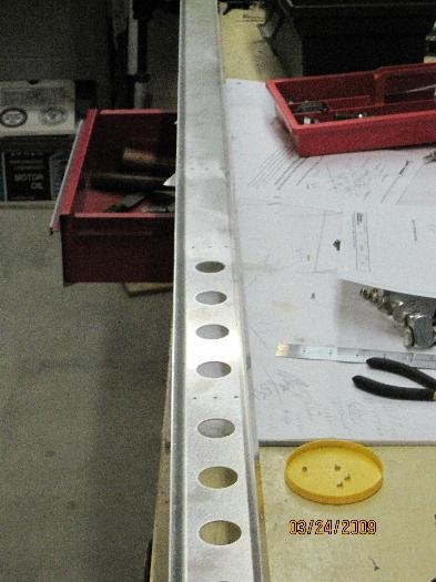

Rear spar

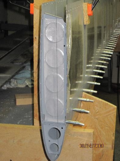

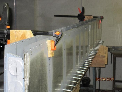

I drilled the rear spar with the hinge bit to get it centered in the dimpled hole. Today I drilled the holes up to #30 size and rejigged the stab for riveting.
