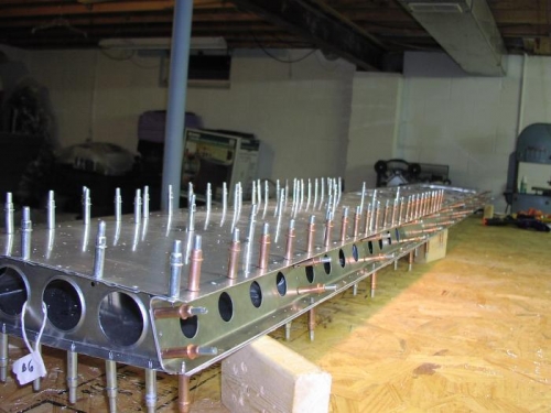

Date:  12-3-2006
Number of Hours:  1.00
Manual Reference:  p22
Brief Description:  Drill the upper right skin
Lots of time with the god old palm drill and clecos. I used the technique outlined in the manual to make sure there was no twist. It was to cut 1/4 x 1/4 x 3 inch pieces of wood. Secure them to my digital level and set it fore to aft on the forward and rear spar. If your readings are identical no twist. Checked the right skin and it looks good.
