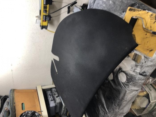

Date:  4-7-2020
Number of Hours:  1.10
Brief Description:  Flocking the glareshield
This is a job I've been holding at the house. I build a stand to secure the glareshield then used a foam roller to spread the adhesive. It is colored black and then I spread the milled felt fibers (flock). Now I wait for 12-15 hours to cure out. It will sit for 36 until I get to it but it looks good.
