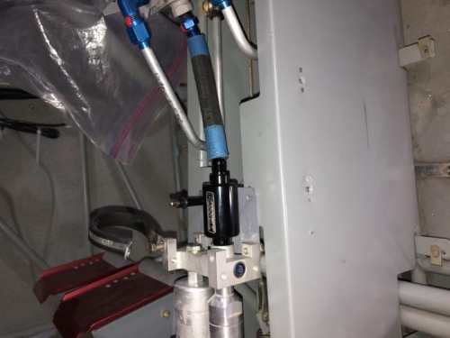

Brief Description:  Solving the fuel leak
After a few calls and research I got a new fuel prefilter and installed it into the boost pump. I this required a little redesign. I went from 9 to 3 conenctions and feel this is a more servicible setup. I have to get a few fittings but am feeling good abut this design.
