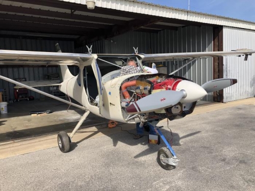

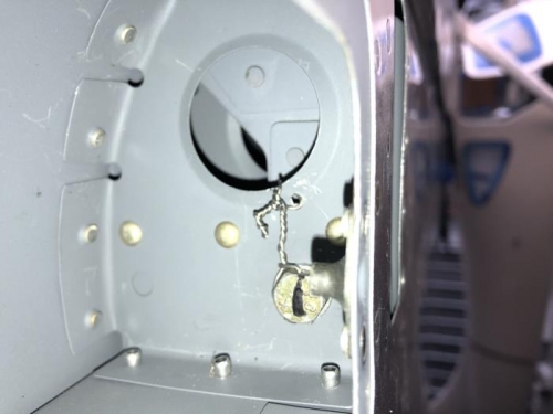

I got 3 of 4 ailerons safety wired then topped off the engine with 8 quarts of mineral oil for break in. I pulled the bird out of the hangar to use the starter to spin the engine and pump oil through the engine. I turned the started for 20 seconds and let the starter cool in between. It took about 45 seconds to get a proper oil pressure reading. I also check the the GPS signal reception which was perfect. Lastly I put a gallon of fuel in the left main to static check for leaks.
