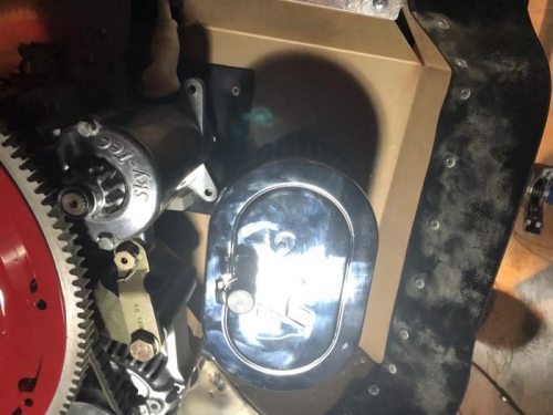

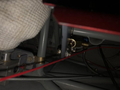

I made a garlock seal for my starter and installed the air filter. It was nice visual progress on the bird. I also worked on a pesky brake leak on my pilot right pedal. There was a 1/8 inch misalignment which made the brake o rings compress on one side and leak. I make adjustments and reconnected I'll see if I have any leaking next session. I have to give it some time.
