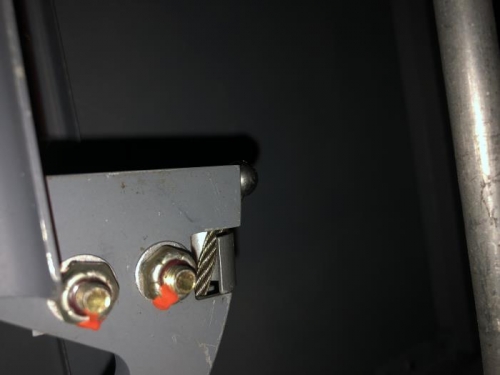

Brief Description:  Flap Issue

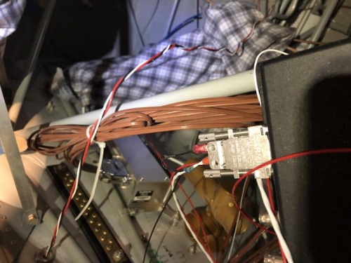

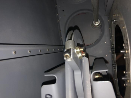

I connected the backsell for te ADS-B out connector and worked on my flaps. I found an issue with the conector at the bellcrank end of the flap. When I installed it I didn't put the ball under the retaining clip. I learned tis after posting on the builders group.
