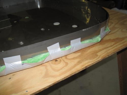

We cleaned and sprayed the adhesive for the firewall insulation. We placed it and trimmed to fit then taped it in place with the fireproof tape. Last step was using the fireproof calk to calk in the corner between the firewall and flange. Once again Dad was a big help.
