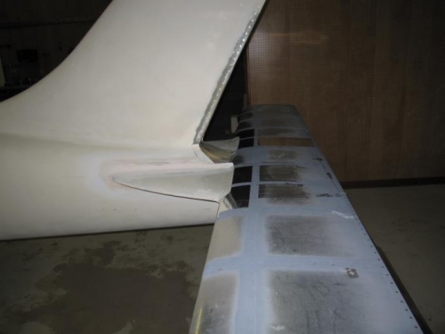

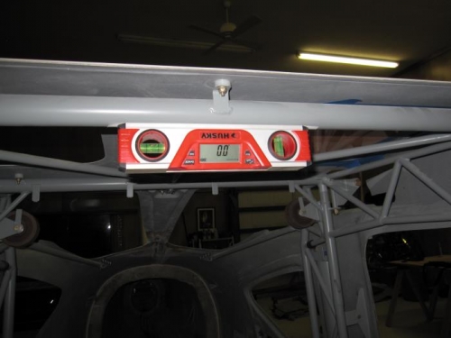

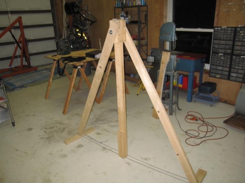

Looking like an airplane. I got into a hangar to setup the horizontal and elevator. I also laterally leveled the fusleage by removing the main wheels and blocking them up. It was pretty close to level but needed a bit of a shim on the left side to get it to 0.0. I also setup the wing stand in preperation of attaching the wings.
