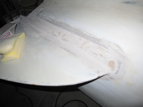

Brief Description:  Sanding strakes

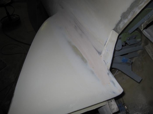

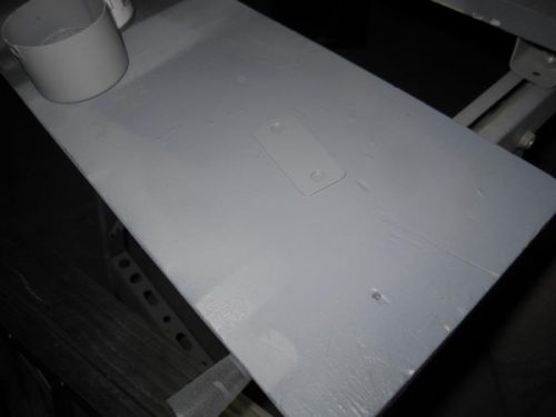

I started working on the sanding of the strake filler it will need several layers to get it looking good. I also finished the upper rudder hinge spacer to adjust for the kit revision of the upside down slingshot on bulkhead C. This reinforces the verticle stabilizer and prevents cracking along the lower rear of the verticle to fuselage seam. It was a problem on some sportsman and Glasair came up with a fix.
