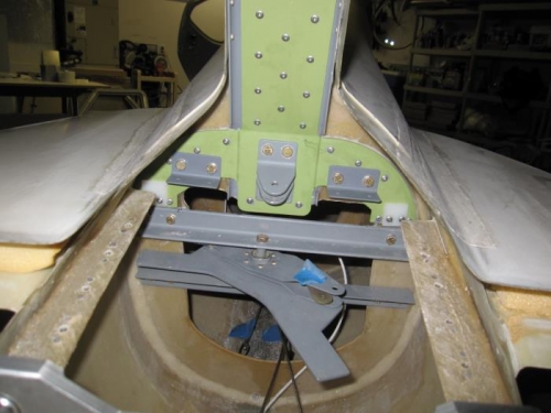

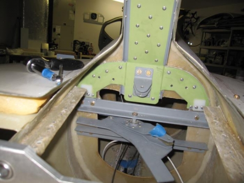

Date:  2-9-2014
Number of Hours:  1.10
Brief Description:  Service Bulliten #1
I crawled back into tailcone and drilled for the lower rudder attach bracket and the shearweb attach brackets. I scared up some longer bolts and bolted the brackets back in place. i am concerned about the bolt holes inteh forwad shear web. I'll get that out and see what we have. I also have to shim the upper rudder hinge .60 to keep the alignment of the lower hinge.
