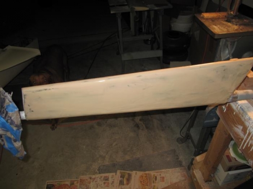

Brief Description:  Gear leg fairings

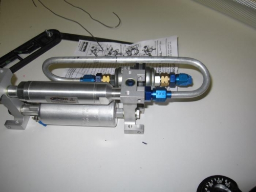

I mixed a batch of filler with epoxy and West fairing material. I spread it on one of the gear legs and let it set. I also started to work the tubing for the boost pump. I found on my first bend that the tube was ruptured. I don't know if it came that way or was damaged in transit. Had to do that one again to be sure.
