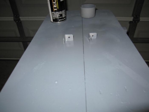

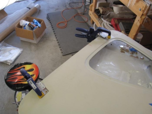

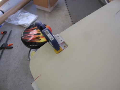

I drilled and set the sureloc fittings to recieve the screw which hold the baggage door hinges on. I then used epoxy to set them in. I also fabricated the panel support brackets and primed them for installation.
